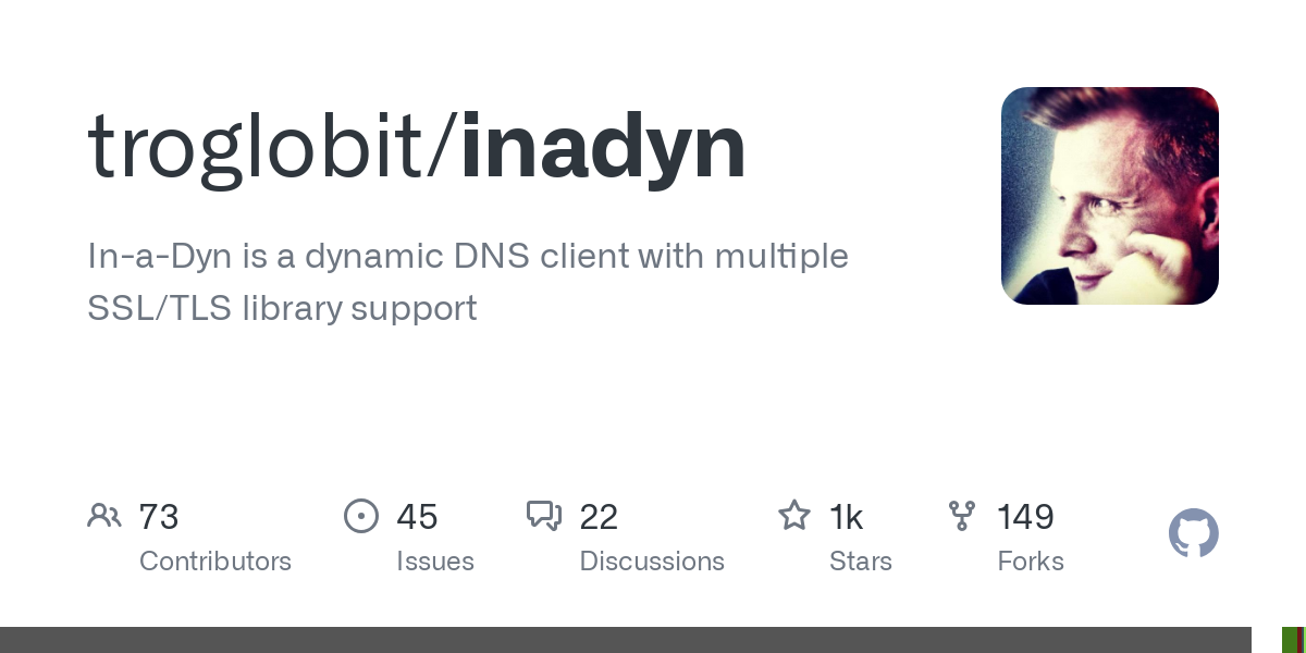

I instead moved to In-a-Dyn (instead of DDClient) as it added support for IPv64.net (IPv4 and IPv6), by Dennis Schröder
https://hub.docker.com/r/troglobit/inadyn
Example config file is found here: inadyn/examples/ipv64.conf at master · troglobit/inadyn · GitHub
If you have multiple sub-domains and you are not wildcarding then you can use a config as follows (Note: the :1 and :2: appended to provider default@ipv64.net)
